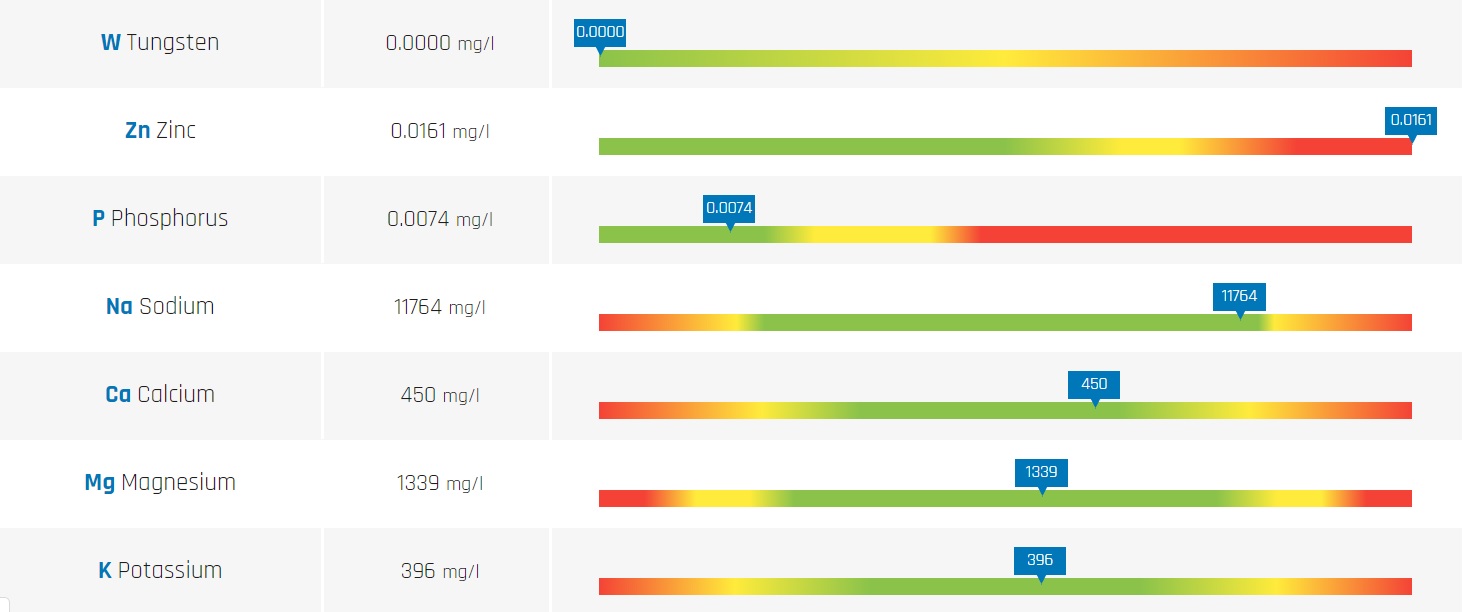

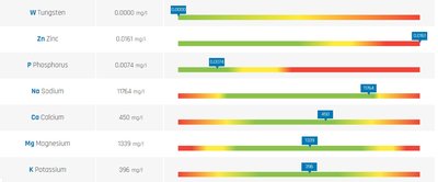

tropicreef Strontium, Bore and Flourine are ok. You can find the full test in the pdf file attached . What about Molybdenum and Zinc? I think both come from Basic as they are considered nutrients /trace elements. I underdosed Sangokai Basis and they are still high, how should I proceed ? I have read Molybdenum is very toxic when in higher quantities , zinc is not that harmful.tropicreef hat geschrieben:Please reduce the salinity to 35psu. Dose Iodine. Suspend Calcium dosing. I miss the values for Strontium, Bore and Flourine?
What about the high levels of Cu and Al ? Should I do a massive water change?

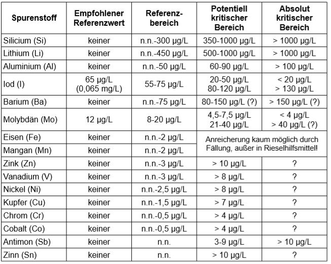

i can't open the pdf file. Error message: file not found. About zinc and molybdenum i wrote a lot here in the forum. like for molybdenum
look also on the tracemetall threshold table

tropicreef hat geschrieben:i can't open the pdf file. Error message: file not found. About zinc and molybdenum i wrote a lot here in the forum. like for
thanks for the chart tropicreef

I got the ICP results from the tank water at 30 March. I uploaded the results and also the results from the tank water present on 2 March.To sum it up the results are very close to each other. Between 2 and 30 March did two major water changes to try to fix the issues highlighted by the first ICP ( both around 75% of total real water volume ). I am new to reefing and ICP but for me it seems that only a few issues can possibly be at fault : the Tropic Marin Pro batch has the elevated levels or Al and Zn ; my rocks - especially the epoxy used leech Al and Zn or the ICP results are not accurate. Can’t imagine the food I add or the nutrients add those components (especially aluminum). What do you think might be the root cause ?
What can I do to reduce it apart from more water changes? The corals and animals don’t show any bad signs that I can recognise apart of the one acropora that does not show it’s polyps at all and looks all brown.
