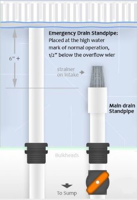

The tank develops a biofilm at the surface of the water but the overflow is not able to handle this kind of problem(see pictures). In 3-4 days the biofilm covers all the surface of the water ( I then proceed to clean it by forcing the emergency overflow into use or stoping the pump , both help force some of it down in the sump). Right now there are no oxygen problems because of the skimmer but I know that this kind of biofilm prevents proper gas exchange. I don't know that is the cause but have two theories. Either the overflow is poorly designed or the return pump has such a low debit that the main overflow just does not have the suction power to get this biofilm with the water in the sump. The pump has a 2.4 m max head and it has a real head in my case of 1.4m plus 2 45* degree joints plus 2 return heads(T type pipe) . Based on the pump power chart excluding the 2x 45* degree joints and the 2 returns it should still have around ~ 1300l/h. What do you think is the cause ?

the biofilm on the water surface impaired the gas exchange. the problem has to be solved
MasterBlaster hat geschrieben:Either the overflow is poorly designed
on the picture i can't see it clearly. Can you please make a sketch from your overflow.
the drain requires two standpipes. One acts as the main drain pipe and creates a full siphon when pulling water from your tank. The other is used as an emergency drain should the main drain become clogged and sits higher than the main siphon pipe. The main drain has an adjustable valve allow for fine tuning of the drain siphon speed resulting in quieter operation and optimal flow through your aquarium. Both the main siphon drain pipe and the emergency pipe must be below the surface of the water. bevel the emergency pipe a little bit.

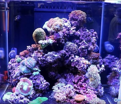

one example for reefbuilding within Aquarium Systems L'Aquarium 250.

Fixed the issues with biofilm by adding water surface tension (I moved a small powerhead near the top) . Apparently without the water making small waves/tension the overflow is not enough to prevent biofilm from appearing. Related to aiptasia , I moved the rock in the sump. If I see other aiptasia heads in the tank I will get the shrimp that eats it and hope for the best. Related to the aquascape it remains work in progress until I find some branch type rock(tanga rock) but I plan to have a much less bulky layout then the one in the picture above, the tank is too small for me to fill it with a hill structure.
